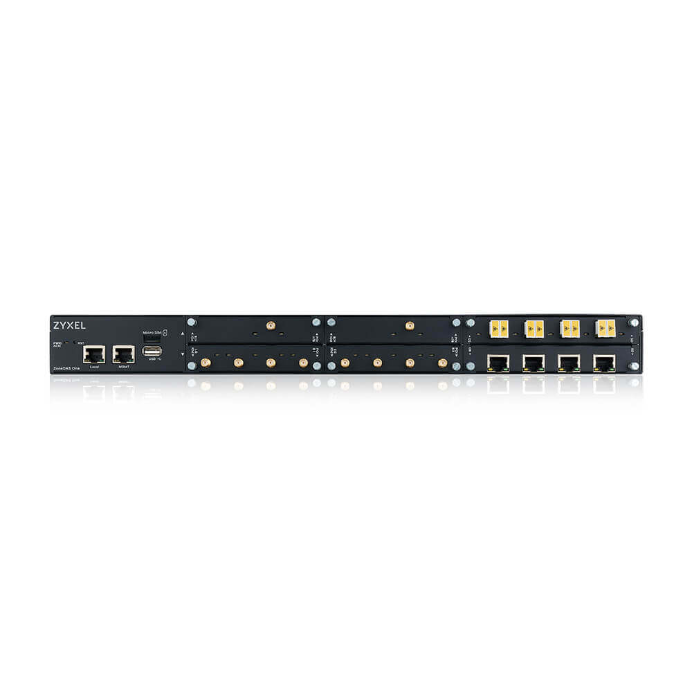

One Base Unit (BU) can support up to 8 Remote units (RUs). With the expanders, one BU can support up to a maximum of 64 RUs.

Base Unit (BU)

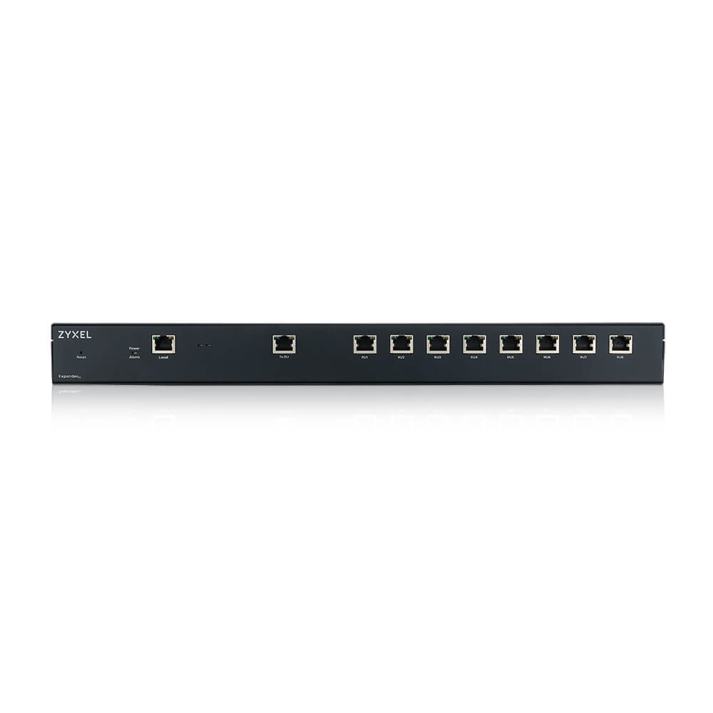

The ZoneDAS series is scalable by adding expanders, with three types available including FC, CC and FF. One FC or CC expander can provide 8 RJ-45 ports to link with 8 remote units (RUs), while one FF expander can provide 16 fiber ports to link with 16 RUs. One BU can connect a maximum of 8 FC, CC, or FF expanders.
